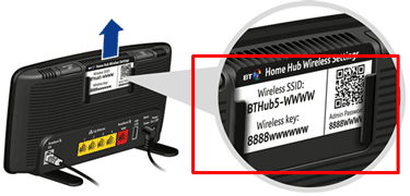

- Choose your Hub from the list (for example, BTHub5-WWWW) and enter the Wireless SSID and Wireless key (password) from the settings card
