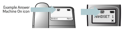

  4. Check the answering machine is on and is set to "Answer and Record" mode. If it is set as "Answer Only", the answering machine won't record any messages.
    When the answering machine is turned on, you'll see an "On" indicator. It is either an icon on the display or a light. For more information check the user guide >
  5.  Example of On indicator
