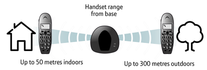

There can be various reasons why you can't get a good range with your cordless phone. The range is the distance you can use the handset from its base. We test our phones to make sure they meet the maximum range of up to 50 metres indoors and up to 300 metres outdoors.
The range of our cordless phones
You will only get this range when there is a clear line of sight between the base and the handset. Anything blocking the base and handset will significantly reduce the range.
