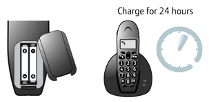

  3. Check the cordless phone batteries are correctly installed and fully charged
  4. Check the handset batteries are correctly installed and fully charged
