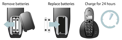

  1. Remove and then replace the handset batteries. Place the handset on the base or charger and allow to charge for up to 24 hours
  2. Remove, replace and then charge the batteries for up to 24 hours
